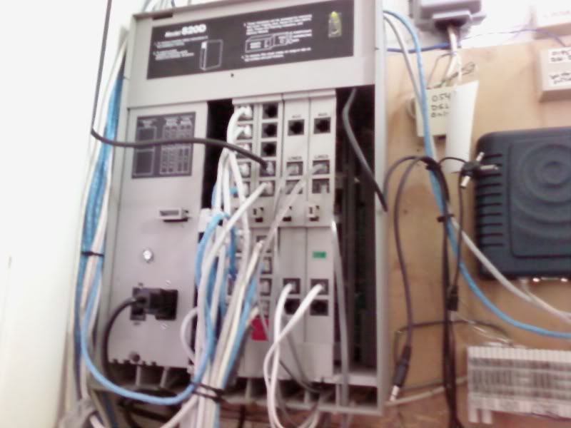

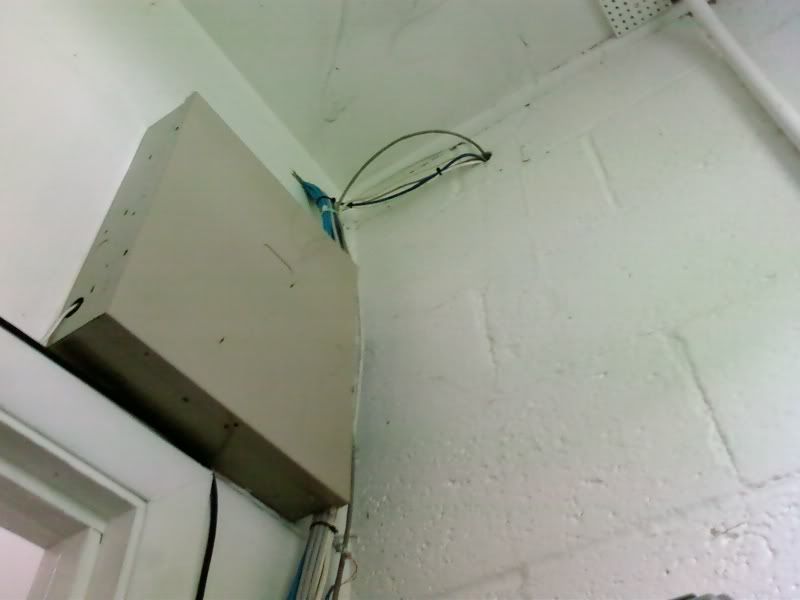

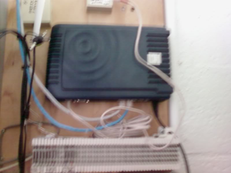

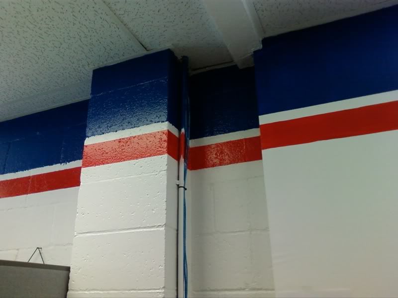

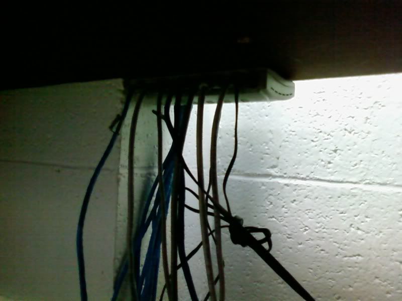

Hey, I got some pics from the office. Turns out it's not routers, their hubs! ... I was able to talk to the hub to see how it's configured, but when it asks for user and pass, I'm not sure what the default is. I've tried: Admin, admin, *blank*, Any, Administrator, and administrator, in various orders. I asked the owner of the company if he knew of anyone who may have changed the password, but he doesn't think so. The hubs are called cayman3000. I googled it, but got nothing. Anyone have any ideas? Anyways, heres some pics and a little explanation of how everything goes:
This is the main DSL line in the back.
this seems to be the switch where all the cables are starting to pour out and into the ceiling.
This is where the wires crawl up the wall
Then, about 20-30feet to our left but still facing the same way, the wires come down through the ceiling.
This is about half the wires, and the other half looks the same way on the other side of the room, but that doesn't matter since they are both the same, but the other hub is not on.
This is where the wires coming from the ceiling lead down to: The Hub. It's only an 8-port hub with the brand(?) name on it: Future power. The rest of the wires lead to phones around each office. All 8 ports are used up. One of the wires from the ceiling lead into the "uplink" port on the hub, and the other ports are all leading out to computers around the office. The gateway IP address is 63.204.***.**.

Well, the Cayman 3000 series is a router/modem. The big box next to it looks as if a telephony box. The last picture you have is a hub. Even though the equipment is old, as long as your running 10/100 you should be fine. Might want to get a linksys router to plug your modem into, and let that control routing. One thing you have to remember about hubs though, is that on some hubs, if you have a cable in the uplink port, and a cable in port 8, port 8's connection could have problems. Such as a client I had, they had a netgear 16 port hub, with one uplink port. IF ANY CONNECTION WAS NEXT TO THE UPLINK PORT, it would not work. I would say try taking that one out, and move it to a different port and see if he recieve DHCP. If yes, then there is your problem, get a bigger hub, or even call someone to go put some hard wired connections through the ceilings to wall ports.
