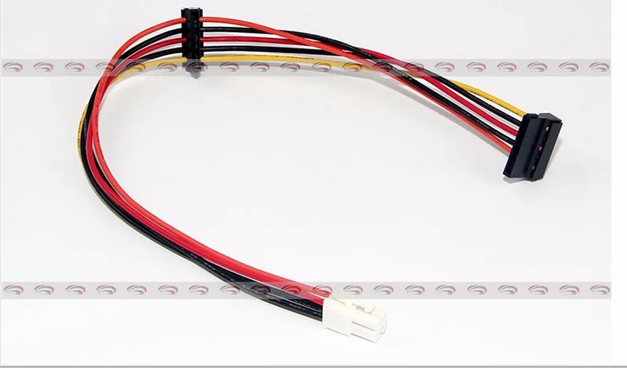

Well to be honest I haven't seen any other motherboards that support these HDD/SSD power cables:
https://ae01.alicdn.com/kf/HTB1ejFyLFXXXXbZXVXXq6xXFXXX6/ATX-font-b-Motherboard-b-font-4pin-to-2-Port-Serial-ATA-SATA-font-b-Hard.jpg
Because thats how my drives are connected to the motherboard right now.

Yeah, that is very weird cable. Anyway black connector seem to be normal SATA found on regular power supplies.

The problem is you have a Medion using their own proprietary design. I'm inclined to agree with the suggestion to sell it and upgrade to something using industry standard parts.

Lenovo does the same thing. 14 pin power and 2 4 pin SATA power connectors on the MB.
https://www.manualslib.com/manual/462274/Lenovo-Thinkcentre-M82.html?page=82#manual

I may be wrong but couldn't you get a new PSU, connect the SATA power cables from the PSU directly to the drives, forgetting the 4 pin connections on the motherboard and purchase a 24pin to 14 pin adapter?
https://www.amazon.com/Power-Supply-Adapter-Cable-Lenovo/dp/B00WE5KSFQ
I generally do not trust that kind of adapters but yes, that is one possibility. Still, buying new LGA1150 motherboard does not sound good idea as old motherboard is almost as good as junk and probably case too. So if that whole machine could be sold, it's probably better deal. There may also be somewhat nasty surprises when upgrading OEM machine.
