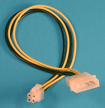

Can you check the power connector for the CPU with a multimeter.
http://www.playtool.com/pages/psuconnectors/connectors.html#atx12v4
If you don't have a multimeter handy to check the CPU connector and the PSU has an available molex connector see if your local source has one of these as shown in the above link.

The multimeter would be able to tell you if you are getting enough voltage to the CPU connector. If the multimeter was not available I was suggesting using a molex to CPU connector to rule out a voltage problem.
