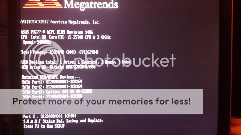

I need to replace a hdd and would appreciate some advice.
On boot up I get the following error screen -

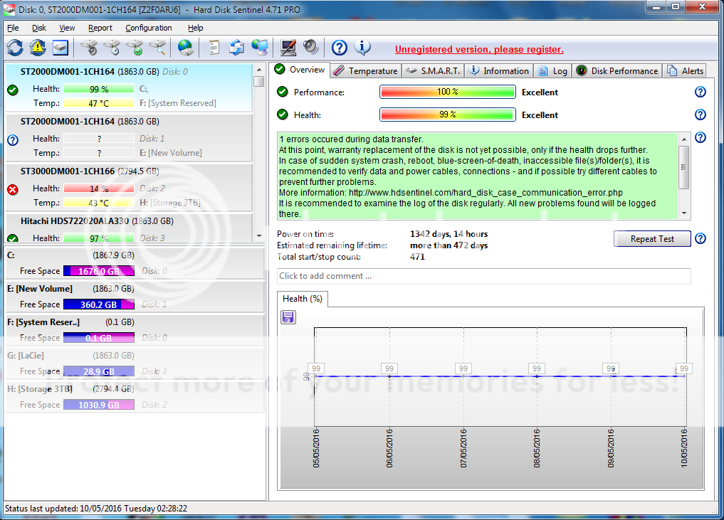

I was able to boot up and run Hard Disk Sentinel -
As you can see from the screenshot, the C drive is ok but the E drive isn’t reporting any data. The H drive is bad… but I think that is a secondary issue and not the reason for the error screen, I will be replacing that drive also though.

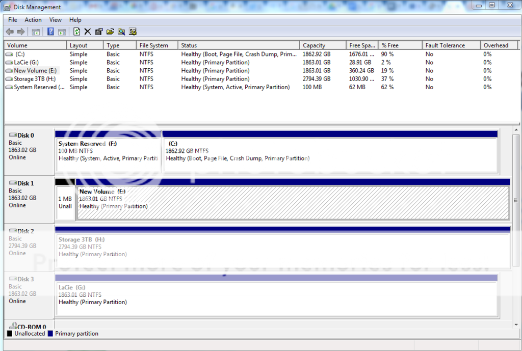

Using Disk Management the drive appears healthy -
Why is the drive inaccessible in Windows Explorer and not reporting in Hard Disk Sentinel?

What I would initially guess/hope from looking at the reported data...would be a loose or bad cable.  I've never seen a report such as yours regarding the E: partition/drive.  The partition seems good as far as being readable/recognized but your 3TB drive looks like you should move everything before doing some testing on it.
I would disconnect/reconnect the E: drive and then check whether Hard Disk Sentinel can detect it properly after reconnection.  Alternately, attach that drive to a different system (using different cable to motherboard) and see if it still is problematical.

Whoa that E drive (Drive 1)  is indeed weird.
It is recognized buy the BIOS.
It is recognized by the OS.
It is recognized by the HD Sentinel app.
Might want to disconnect the external drive since it seems to be equally flaky and might be responsible for internal drives reporting issues.

I presume the E: drive had data on it.  And was a working drive (single partition?).  It almost looks as if any MBR data was lost leaving the appearance of a blank NTFS formatted 2TB drive but 81% full.  I am assuming this was not GPT partitioned? That then begs the question what happened to cause that?  Could be the drive, could be some app/OS messed it up.

Eh it may be giving false positives, hard disk sentinel is known to do that
