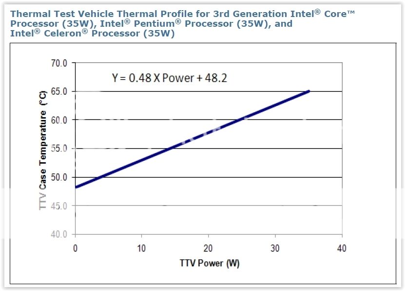

The average and the peak temperatures:
Average: 65 ºC
Peak: 67 ºC
When loading IE: Peak 70 ºC
When loading Chrome: Peak 76 ºC
Temperatures of individual processors:
Core 0: 64º C
Core 1: 64º C
Sometimes one or the other gets hotter by 2 or 3 ºC
Their core speeds varies.
Intel Turbo Boost Technology Monitor 2.6 seems to be acting here.

Behavior of MSIE in Task Manager is not uncommon, but the high temperatures and RAM usage of Chrome concern me. The maximum case temperature for your processor is 65°C.
Intel%20i7-3537U%20Temperature%20Chart.j
Check to be sure the air inlets and outlets around your computer's case are unobstructed.
Although it's possible that the CPU's thermal protection is pausing your PC, I'd like to test the health of your physical disk.
