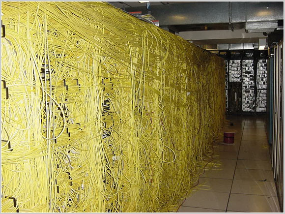

Cable Management. Now days we refuse to by any cabinet that does not allow for good vertical cable management as no one likes trying to troubleshoot a spaghetti monster.
