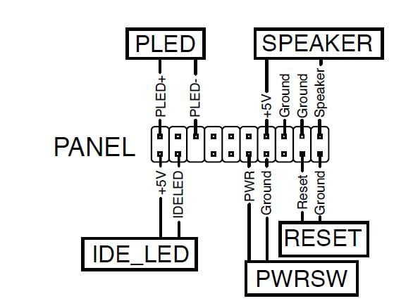

It sounds an odd problem, and one I have not seen myself.  Just an idea but have you tried disconnecting the power switch wire from the motherboard?  There will be a group of wires going to some pins on the board (reset switch, power led, hdd led etc.) - it should be labelled POWER SW or similar on the plug.  The group is usually in bottom left corner of the motherboard, when viewing from the front.
Here's a fairly common pinout
Without a power switch, you can start the PC by shorting the two power switch pins with a screwdriver.
If it still does the automatic power on behaviour with the switch disconnected, I'd have to conclude something was very wrong with the motherboard also.
