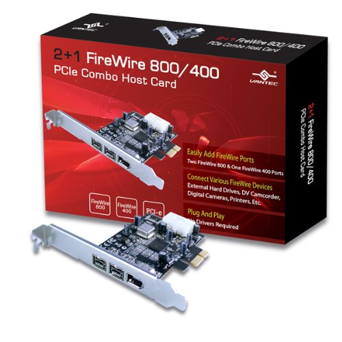

#15 Steve Lum
Steve Lum
  • Local time:11:57 PM
Posted 17 December 2015 - 12:41 PM
I resolved my VIA problem by buying a new PCIE card back near when I originally posted - have never had a problem since.  I bought this Vantec card off Amazon
http://ecx.images-amazon.com/images/I/51GRW4QiynL.jpg
Good luck folks!
