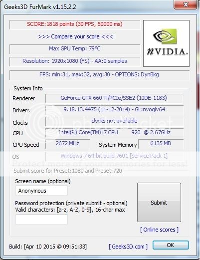

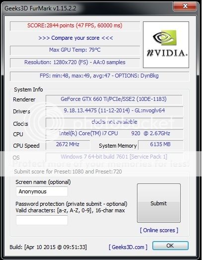

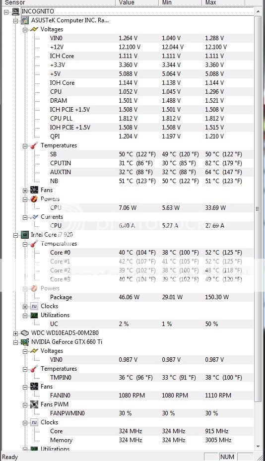

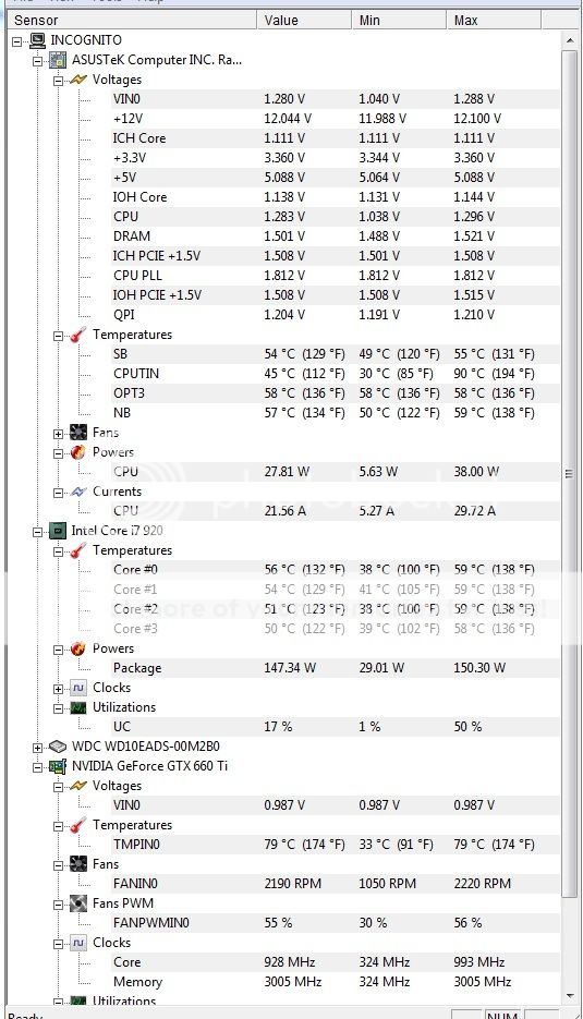

Ok... figured out spoilers so that's how I'll be giving all of my info from now on except what I type obviously.  Alright, so what is to follow is monitored voltages, and temps for my system.  I'm running out for a memory stick so I can run a boot up memtest to see if something is wonky there (currently still packed awaiting tenents to move out so I can move into my house.  So I'm not sure where mine even is).
Resting Benchmark voltages/temps
Spoiler
1080 GPU Benchmark
Spoiler
720 GPU Benchmark
Spoiler
GPU Stress Test Monitor
Spoiler

Posted 26 May 2015 - 04:33 AM
Please note your GPU temps (79ºC).  Not overly hot for a GPU, but still pretty hot.
Gotta wonder if it has gotten even hotter (which would cause random shutdowns.
But this isn't likely to be the cause when booting up from a "cold" state.
Can you try another video card?  Can you try reseating the current card?
I'll need these reports for further troubleshooting (even though you're not seeing BSOD's):      http://www.bleepingcomputer.com/forums/t/576314/blue-screen-of-death-bsod-posting-instructions-windows-10-81-8-7-vista/

I did notice the GPU temp getting up to 79 but it seemed to stay steady there and peaked off after getting up to that temp and ran that way for about 20 minutes before I shut the test down.
