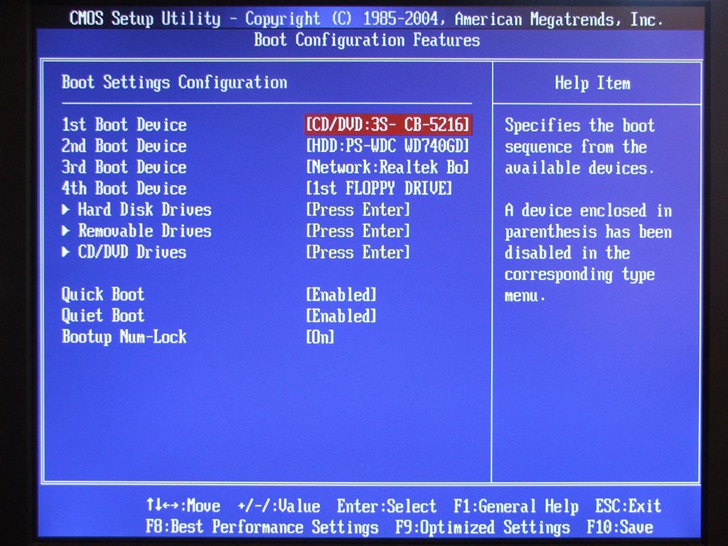

From what I read, that particular motherboard doesn't have a quick boot menu. Changing the boot order is something you should only attempt if you are familiar enough with the computer's BIOS to be able to undo any changes you make.
You would have press DELETE to enter the BIOS setup, then select the Boot Configuration Features menu and press enter, then use the '+' and '-' keys to move the CD/DVD to the first position and your HDD to second (assuming your HDD is 1st Boot Device right now).
1680_p5_4.jpg?
Press F10 to save your changes, and choose 'Y' to confirm.
If you decide to do that, please include what shows up to the right of 'HDD:' (such as ';WDC WD7500BPKT').
