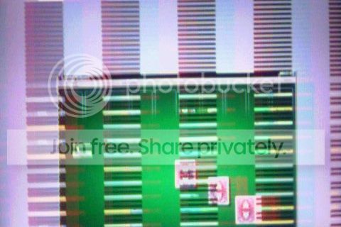

Tonight I went and bought a Netgear N150 wireless USB adapter to replace the Linksys, since I've been meaning to do that anyway. I was also searching online for problems similar to mine and saw somebody else mentioned having a Linksys (different model) that might be acting up, so I wondered if there was a connection. Either way, I'm considering returning this computer even though I don't really want to since time is short and I'd rather not get stuck with yet another machine that needs fixing. Last night I went to backup the few files I have saved here with my new flashdrive and as the following screencap will show you, my computer "freaked out" yet again as I was getting ready to play a game of Spider Solitaire while I was waiting, although it didn't make any noise this time. But that was the fourth time now and I just can't put up with it anymore.
Here's a picture I took with my really old, crappy phone before I had to restart to give an example of what it looks like.
Any ideas?

Hello! I really don't have any ideas. Returning it is probably a good idea. Does it have a on board graphic card ?
The graphic card  could be the problem. You could have a bad cable or mad monitor. I think returning it is a good idea!

Go to the Intel website and use their automated driver search to find the best driver for your integrated graphics and install it.
If this does not resolve the issue you should try using a monitor which is known to be good.  If the problem persists the integrated graphics chip could be failing.  If this is the case you should return the computer as it will require replacing the motherboard to fix this.

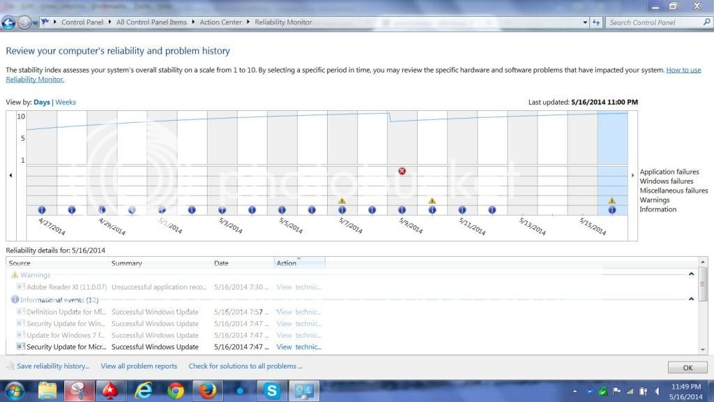

#11 donetao
donetao
  • 270 posts
  • Local time:08:39 AM
Posted 20 May 2014 - 11:02 PM
Hello You should see some thing like this!
Thank you!!
