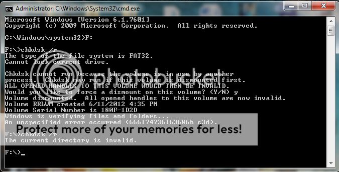

Thanks for your help. I ran Check disk on the system drive and it said C volume is clean. I then tried to run it on the External HD a few times and kept getting the message in the photo below.
F_drive_chkdsk.jpg?t=1381805461
Posted below is the Minitoolbox report and here is the link to the Speccy snapshot: http://speccy.piriform.com/results/R1qLdGvuQwzwf41GUGT6pQw

#4 wicks_10
wicks_10
  • 47 posts
  • Local time:08:02 PM
Posted 15 October 2013 - 03:52 PM
An update. When the HD is left plugged in while the computer is in standby, it will give an error upon waking up that the drive has failed to mount or something like that. Under device manager, it says that "Windows has stopped this device because it has reported problems. (Code 43)."
#5 hamluis
  • 56,415 posts
  • Local time:09:02 PM
Posted 17 October 2013 - 10:52 AM
Max temperature for your CPU seems to be 62 Celsius, current is 52 Celsius.
Nothing obvious in Speccy data.
Seems clear that your external hard drive is a problem...is failing.  Could be the drive itself, could be the enclosure...the device is a problem.  Not sure why programs would be on an external drive, with plenty of room on the hard drive.  In any case...I suggest trying to move any valued data from the external drive to the internal drive.
#6 wicks_10
wicks_10
  • 47 posts
Posted 17 October 2013 - 02:57 PM
Thanks Louis. I'll give the company a call then. The program is about 80 GB so I think that is why it stays on the supplied HD. After the school year, you send it back. My assumption is that it has been used by many different people over a few years and after the use everyday, probably just starting to crap out. Hope they will just send a new one without much hassle. Oh joy I guess. Thanks again.
#7 hamluis
  • 56,415 posts
Posted 17 October 2013 - 05:14 PM
Easily done, happy computing :).
