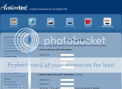

Once you are logged into the routers administration page please go to the Advanced Setup page which should look something like this ->GT784WN3.jpg
The starting point for the first port you'll be forwarding is 80. So input 80 as the starting and 80 as the ending. Protocol will be tcp, and lan ip address will be ip address of the dvr.
Once you have that done please click apply. It may refresh the page for you to input any more ports that need to be forwarded. Now you'll need to enter 6036 for the starting and 6036 as the ending, protocol will be tcp and lan ip will be ip address of the dvr. Once done click apply. That's it and you should be done with the forwarding.
