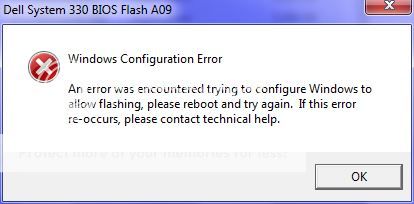

By the way, I don't know if this has any relevance...
When I turn on the computer, there is no option to boot BIOS. There are F2 and F10 options and they both take me to the same place: some system settings/properties application. I went to the Dell website and downloaded a BIOS upgrade. This is what happened when I tried to install it.

  • Local time:03:40 PM
Posted 04 September 2013 - 11:54 AM
it is common for browsers to be the biggest of the apps using memory.   have you recently been suggested by your system to do any automatic updates to anything by just clicking on the yes and/or ok button?
Just Windows Updates, which I recently turned off because of the freezes. I'm afraid it's going to lock up in the middle of one and totally ruin my system.

whoa, then like whoa,
      ok, BIOS flashing is whole new adventure. although it might be related to the topic. some users feel the need to leave it alone. others like to toy in the settings and/or flash it. I am the former.

Posted 04 September 2013 - 12:09 PM
Got the BIOS upgrade to work.
Yet another mistake. My Boot Menu works now. I've run a Pre-boot diagnostic test and it passes.
No freezes since the upgrade. Stay tuned..lol
