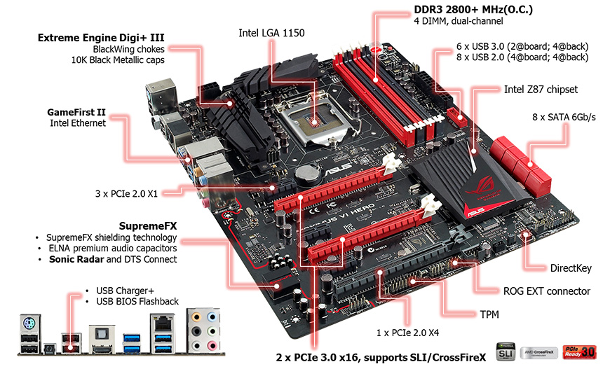

According to the official specs, there are eight USB 2.0 ports available in your machine. Four of them are in the backside (the black ones ) and other four are in front panel. All blue ports are USB 3.0 ports.

I have 4 USB 2.0 and 6 USB 3.0 ports :(
unless I change what the USB 3.0 ports cable for the front of the case go to and pluch them into the USB 2.0 header on the mobo.
Edited by siliconart, 05 September 2013 - 11:39 AM.
