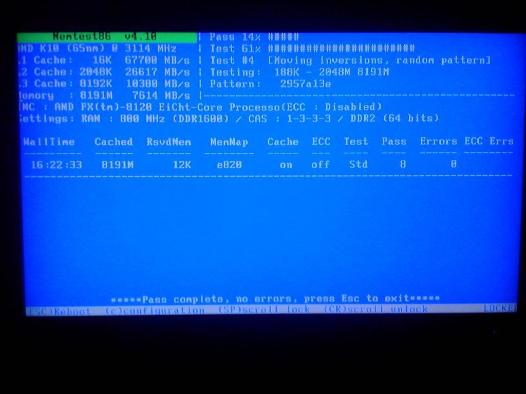

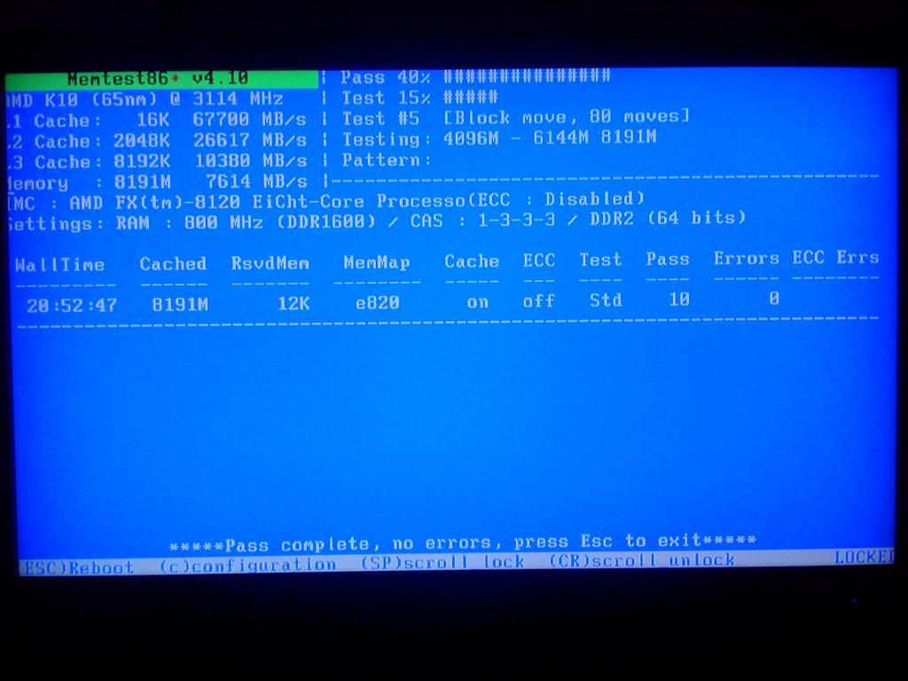

Now, for the Memtest I know you said it would take "several hours"; I don't know if its just my computer but my test finished in almost 21 hours... (20:52:47). I had to manually set the USB to start as primary from the BIOS as it didn't begin the test right off from boot, after that the test ran the whole day. I've included two pictures I took of the test at "test pass" # 8 & 10 below. I didn't get any errors throughout the whole test nor did I see any "red lines" where the error line is located either. Thanks for the input yet again and let me know what you think.

Posted 18 July 2013 - 02:42 AM
Hi
Thanks for providing the updates. I really appreciate your patience and willingness to solve the problem.
Your memory looks fine and temperature status is also good. So most possibly this will be a software issue than a  hardware problem.
Can you please upload all the crash dump files located under the C:\Windows\Minidump folder ?  . I am currently analyzing the dump you previously posted but more than one dump is necessary to find a probable cause.
I will keep you posted after the analysis finished.
