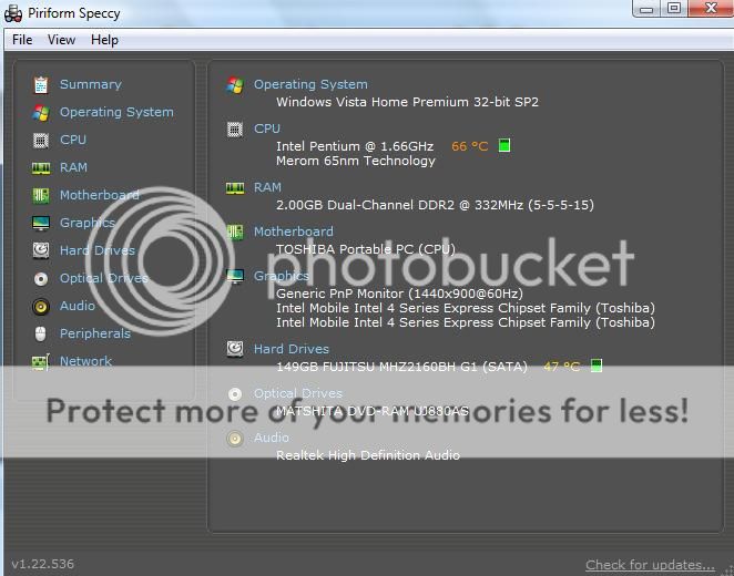

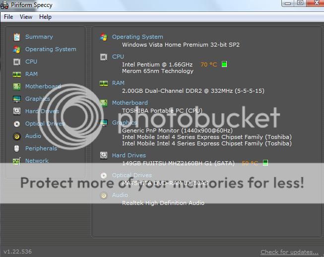

The laptop will boot into safe mode and seems fine but then again when I boot it up normal it can be fine for a bit as well, this morning I was using it for a good few hours before it froze on me.
>> Where it says CPU since I've been watching it I've seen the temperature number and it's not been lower than above 58 since I've been watching it but it has been has high as 70 and now I can hear the fan going and it's hovering at 64 if that means anything. The hard drive temp doesn't really change as much as the CPU one it was 46 and now it's 50/51 and the CPU temp as gone back down to 61.
This is what the temperatures are at the time of posting this message apart from the CPU has gone down to 66 now.
I've always got my laptop on a table and have tilted it up further to let the fan underneath have more air. It's froze a few times on me today.

I will keep watching the temperature readings and add another post if any big increases in temperature is seen. Thank you for helping me.
__________________________________________________________________________
The computer just froze again and the temp readings were:CPU: 57 Hard drive 46
Edited by ~ JJ ~, 18 July 2013 - 11:37 AM.
#4 Anshad Edavana
Anshad Edavana
  • 2,805 posts
  • Location:India
  • Local time:04:10 AM
Posted 19 July 2013 - 11:21 AM
Hi
Your CPU temperature is definitely high and that might be the reason for freezing. Disassembling the system, cleaning all dusts, properly re-applying thermal paste etc are necessary to fix the heat issue. There is also chance that the CPU cooling fa might be faulty.
Disassembling and cleaning the laptop requires fair knowledge in computer hardware and previous disassembling experience. I suggest hiring the help of a friend or a professional PC tech to do the job. If you are sure that you can do the job yourself, i will provide the guidance.
