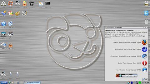

Boot with the Lucid Puppy CD.
  • Instructions prepared June 10th, 2012, using Lucid Puppy version 5.2.8
Lucid Puppy 5.2.8 desktop with browser wizard.
Download and install GSmartControl package:
  • At the Puppy Desktop, click on Install.
    A new Install window will appear.
  • At the bottom of that window, "Click button to run the Puppy Package Manager".
    The Puppy Package Manager window will appear.
  • On the left-side of that window you will see a vertical column of icons: Click on the second icon "System".
  • In the window pane to the right-side, under the heading "Package", eighth down the list, click on "gsmartcontrol-0.8.5-i386".
    A Puppy Package Manager: preinstall window will appear.
  • In that window, if all is well, at the bottom, click on "Install gsmartcontrol-0.8.5-i386".
    A Puppy Package Manager: download window will appear.
  • I didn't have any luck with the download location selected by default, so I suggest that you select "ibiblio.org", third from the bottom, and then click on "Download Packages".
    You will see a download progress window, and then a "Puppy Package Manager" window announcing that the packages have been successfully installed.
  • Click OK.
  • If all is well, you will see another window announcing that there are no missing libraries or dependencies: Click OK.
  • You will have a remaining Puppy Package Manager window open, so click on "Exit package manager" to close the window.
Done!
Use GSmartControl to get the S.M.A.R.T data:
  • At the bottom-left-side of the Puppy Desktop
  • Click Menu > System > System Status and Config > GSmartControl hardware information.
  • In the GSmartControl window that appears, click on the device that represents the failing hard drive (any other device may be a flashdrive if you have one connected) to select it.
  • On the top menu, click Device > View Details.
    A Device Information window for the failing hard drive will open.
  • Click on the Attributes tab at the top (to display the S.M.A.R.T data).
:step1: Firstly, we'll save the S.M.A.R.T data as a text output by smartctl.
  • At the bottom of the Attributes page, click Save As.
  • Look at the default file name and location that the file will be saved.
    Default location will be "root".
  • Click Save.
:step2: Now, let's create and save a screenshot of the GSmartControl window.
  • Firstly, make the GSmartControl window occupy the full size of the screen so that all details are included in the screenshot.
  • Click on Menu (bottom-left corner of the screen) > Graphic > PupSnap Screen Capture.
    A PupSnap window will appear.
  • Click the Full Screen tab in that window.
  • Click Save.
    A new window displaying the newly created screenshot (probably named image-1.png) will appear.
  • Close that window, exit the PupSnap window, as well as the Device Information window and the GSmartControl window.
Done!
Now to get the text file and the screenshot uploaded to BleepingComputer.com.
You are probably already reading this using Puppy, but if not ...
Attach items to a post or two ...
  • In your topic at the bottom of the page, click on Add Reply.
  • Under the text box, under the heading Attachments, click on "Browse" to browse for the file that you wish to attach.
    A file upload window will appear.
  • On the left-side, click on "root" to display the contents of the root directory.
  • You should see the text file there that you saved earlier. Click on it, to select it, and then click Open at the bottom-right of the window.
  • Back at the BleepingComputer.com forums window, click on Attach this file.
  • Now type a few words in the text box "text file attached" and then at the bottom click on Add Reply.
Note: If you are feeling confident enough to try it, you can open the text file with a text editor in Puppy and paste the contents in a reply so it can be seen easily by anyone browsing the topic, if you wish. If you do this, don't forget to enclose in CODE tags to preserve the format/spacing.
Now click on Add Reply again to create another post.
  • Again, click on Browse under Attachments.
  • In the root directory, double-click on my-documents to open that directory.
  • In that directory, double-click on images to open that directory.
    You should now see the image that you saved (the screenshot) probably called image-1.png
  • Click on the image to highlight it, and then click on Open.
  • Back at the forum, click on Attach This File.
  • When it has been attached (may take a few seconds), to the right of the window, click on "Add to Post" so that the image will be displayed.
    You will see some text appear in the text box.
  • At the bottom of the window, click on Add Reply.
All done!
Edited by AustrAlien, 11 July 2012 - 06:10 AM.

AND ... in another senior's moment, I forgot to give you this bit to start with. More fun!! Enjoy.
If your computer is not able to boot into Windows or simply not able to access the internet, you can use a LIVE Linux operating system run from a bootable CD or flashdrive instead of Windows, to access the internet, to access files on the HDD(s) and do other tasks.
:step1: Using a working computer:
  • If you wish to use a LIVE CD ...
    • Download the Linux version of your choice (usually an .ISO image file).
    • There are many options to use for a LIVE CD. I suggest that you try one of the following:
    • Puppy Linux (smallest download file size at 128 MB)
    • There are two versions currently available, namely Slacko and Lucid. Either will do the job nicely.
  • Linux Mint 12 Lisa (versions for a CD, and larger versions that need to be burned to a DVD disk)
[*]Burn the .ISO image to CD: If you do not already have a suitable burning program for writing .ISO images to disc ...
  • Download and install ImgBurn.
  • Ensure that you UN-check the box agreeing to install the Ask toolbar during the installation.
  • Place a new (blank) CD disc in the drive tray.
  • Choose Write image file to disc.
    • Under Source, click on the Browse button: Navigate to and select the .ISO file that you wish to burn.
    • Place a check-mark in the box beside Verify.
  • Click Posted Image
[*]When the CD has been burned and verified as successful, it will be bootable.
[/list][*]OR ... if you wish to use a LIVE flashdrive ...
  • Go to UNetbootin - Homepage and Downloads and at the top of the page, click on Download (for Windows) to download the application.
  • Follow the instructions further down the page under the heading Installation & Screenshots.
  • Run the application to download and install the Linux version of choice to your flashdrive.
  • I suggest that you try one of the following:
  • Linux Mint 12 Lisa (download file size depends on version)
[/list][/list]
:step2: Boot the problematic machine from the LIVE CD or flashdrive.
  • (You may have to configure the Boot Menu or BIOS Setup Menu to boot first from the optical/CD drive or the flashdrive, which ever you are using.)
  • Choose to run the Linux operating system from the CD or flashdrive without making any changes to your computer.
    Do NOT install Linux on your hard drive.
  • When the Linux operating system loads ...
  • You will have internet access in the normal manner.
  • You will be able to navigate to all the files on your HDD.
  • You can backup your files by copying them to a flashdrive or an external hard drive.
