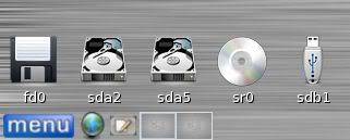

  • Note the icons, bottom left, above the Menu button. They represent each drive on your computer. Plug in your USB Flash drive if you haven't already. The flash drive icon will soon appear.
  • Unlike Windows, in Puppy you only have to mouse click once on an icon to open it.
  • Find your system hard drive by exploring the hard drive icons ("hda" or "sda").

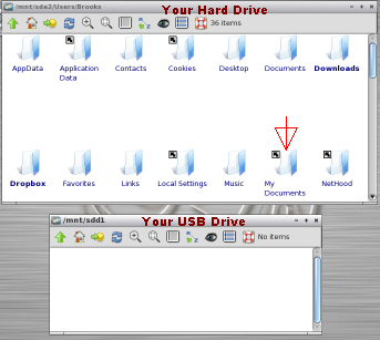

  • WINDOWS Vista and 7 - Click once on your hard drive. Go to "My Documents" folder by clicking "Users," then "<YourUserName>." You will see the "My Documents" folder.
  • Click once on your USB drive. Now arrange the two screens by dragging them using the top, title bar so that both are visible; one on top of the other. Each window can be made smaller by positioning your mouse either on the top or right side of each window.
  • Drag the "My Documents" folder into the USB drive and release. Click "Copy." Do the same for any other folders or files that are important.
  • When the Flash drive is full, you can right mouse click on the Desktop Flash Drive icon and select "Dismount." Remove Flash drive and copy files to another computer. Re-insert Flash drive into unbootable system to recover additional files.
  • To "Exit" Puppy Linux, click "Menu," "Shutdown," and "Reboot." You will be presented with a screen asking to save any personal settings. Arrow over to "Do Not Save" and press <Enter>. The system will reboot. Remove the CD.
