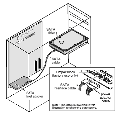

Adding a second drive is one of the easiest upgrades you can make to a PC. Generally, you don't even need to enter the BIOS at all and all you need is a screwdriver.
First, look at the specifications for your computer's model and determine whether it supports PATA(IDE, most older PCs and many newer ones support this,) SATA2 (supported by almost all PCs since 2007 or so,) or SATA3 which is all the new hotness and is supported by most newer PCs. It's not uncommon for a computer to support all three interfaces, though an off-the-shelf model like a Dell is less likely to support more than one. Given the choice, you should opt for SATA3, since it's the fastest followed by SATA2 and finally PATA.
If you computer supports only PATA drives, then you may want to look into getting a SATA controller card. These are expansion cards that plug in to a PCI card slot and provide one or more SATA2/3 ports. If you go this route you may need to install the SATA controller card's drivers before installing the drive itself.
Once you determine the type of drive you can use, you can simply pick one of the many, many models of hard drive that are available for each type. Bigger drives are obviously better than smaller ones, and faster RPM drives are better than slower RPM drives; a good target is 7200RPM (assuming you don't opt for an SSD, which has no moving parts at all.)
After getting the drive, all that remains is to install it and set it up. Installing is very simple as all you need to do is connect 1 cable to the motherboard and 1 cable to the power supply (and secure the drive with screws, of course.)

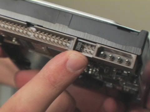

You may need to set a jumper on the hard drive to enable or disable certain features, the manual with the drive will explain the different options and provide a diagram for reference. Jumpers are small metal pins which form part of a broken circuit. Jumper covers are small plastic and metal sleeves that fit over two jumpers to complete the circuit and thereby change a particular behavior of the drive (notice the small black square of plastic the finger is pointing to):
