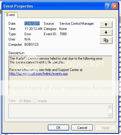

I have an emachines computer with an AMD processor, running Windows XP service pack three. Last week the computer started hanging on bootup or just booting to a black screen. The emachines splash screen will flash and then the screen that shows which version of windows it starting up then the screen goes black for up to five minutes before the starting windows splash screen flashes. From there it hangs for up to fifteen minutes and then again with the desktop but no icons. Or it doesn't show anything and you just get a black screen. This whole process is taking up to an hour of trying to get the computer up. Today I clicked on the recovery console choice in the second screen and it said please wait for over twenty minutes, windows started and it hung up at the desk top again for a while.
I looked in the event viewer under system and there are disk errors that say "A driver detected a controller error on\device\hardisk1\D. I looked in the device manager and everything seems fine. Friday a ran check disk and it did not come up with any errors.
Do you think this is a windows issue or is my hard drive going bad? I don't know the hard drive manufacturer so I could download a diagnostic program. I checked the documentation that came with the computer and I can't find it. My next step is going to be to open the computer and make sure all the cables and cards are seated properly but I am afraid to turn it off. Any advise you could provide would be greatly appreciated.

I opened the case this morning, blew out the dust and checked all the cables were seated properly. Then I started it up and it was fine until the Windows XP splash screen came up. The bar stopped moving and I waited 10 minutes and then did a hard boot. I tried booting up to the recovery console but after the starting windows screen it just went black and nothing happened. I hard booted into safe mode and it booted up very quickly with no issues. I determined that I had a western digital hard drive so I downloaded their diagnostic utility. I tried to run it while I was in safe mode and it did not recognize any physical drives, which was weird. I rebooted it normally and it started right up lickity split with no issues. I ran the diagnostic program again and it came up with all the drives. A quick test came up with no errors. I plan on running the extended test before I go home because it says it takes hours.
So here is the thing, I am working on the computer, all my programs are running fine, I hear a click and the screen goes black. I turn it off and boot it up again, no problems it boots up right away. I'd had it on for about 1/2 an hour, I was typing this response and click, black screen again. I restarted, went to event viewer, there are no disk errors since yesterday. The only errors correspond with the black scree. Here is the error:
Computer just blacked out again and I had to reboot. So I wonder if some other piece of hardware it going bad like my video card or the mother board or if it is time to get a new computer. I could reinstall the operating system but it seems like a hardware issue not a software issue.

I plan on running the diagnostic a couple hours before I leave in case it takes forever. I did not pull the cables off completely and re-seat them. I just made sure they were pushed in good. My computer is booting up fine now but when I try to print, it clicks and goes to the black screen. When I look at the event viewer when I get back in the only error message is the radio pl service that I posted a picture of above.

I tried to run the diagnostic test last night but the computer would click to black screen after a few minutes in. This morning I opened the case and disconnected and reconnected the cables from the mother board and the hard drive. Today although it boots up fine, it clicks to the black screen within a few minutes. I can't even work on it. I just don't know if I should replace the hard drive or scrap the whole computer. I would like to do the cheapest thing possible. I don't want to buy a hard drive and then find out I need a whole new computer.
Any advise?
