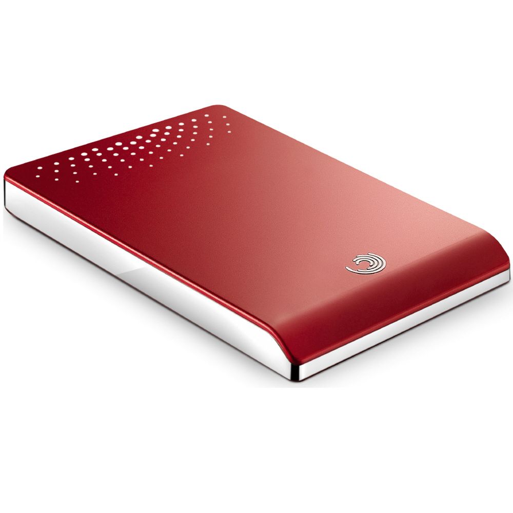

I once again need your guys expertise help in solving another problem. THis was my last result, I have been trolling through forums after forums and I can not find an answer just more questions..... Any help would be awesome!!!!
PROBLEM: I have a Seagate Freeagent Go 640gb external Hard Drive, I have had this drive for a little over a year now, Just today when I hook it to my laptop(usb) windows says the device is not recognized and its malfunctioning... It worked this morning, I hit "remove safe hardware" it said it was safe to remove and I removed it and went to school. Then when I get home and I try it, says it can not be recognized. I have tried several things. I have checked device manager and it does not show up as hard drive, rather it shows as unrecognized USB port. I have tried this drive on 3 other computers laptops and desktops, all running windows, 2 windows 7 and the 1 on XP and says the same thing. I have uninstalled the USB driver and reinstalled (found on forums) and did not fix it. Another thing I have tried is plugging it into a USB wall converter to power it and still same problem. I am freaking out....
When I plug it in, the light on the external hard drive comes on, sometimes it will beep for a few then just go dead. Under the My Computer Tab where the C:/ drive is located it does not show up as a drive, I tried to do chkdsk g: /r and it does not show at all. I have tried everything I have read on other forums. Seagate the company said they would repair and save all my data for $700, yes seven hundred dollars, wow. I dont have $700 lol. The only thing it says is, Windows can not recognize this device, (running windows 7 64 bit) same with windows xp service pack 3. So I know its not a USB port problem, its the external hard drive, I can not get windows to recognize it no matter what I DO. I am very frustrated. It worked before I left and now its shot....
QUESTION: Does this mean my external hard drive is done?? Like its dead, non reparable (for I have had no help reading forums and Seagate is the most unhelpful people I have spent 4 hours on hold talking to.) some of my data is backed up, save expect a handful of movies, music, games and most important school work. Can I pry open the plastic case and use it as an internal hard drive? (I know this voids the warranty, which mine is probably expired) I do need about 20gb of data off of it for college, ( that I do not have backed up yet) I am scared I lost everything, I can not get any of the PC's to recognize it, I have tried all trouble shooting steps offered by Seagate (most worthless advice) I am running Windows 7 atm, My External Hard Drive will not show up as a drive, it says Unrecognized USB device, Device is malfunctioning. I hope I did not lose all my data... I am willing to try anything to access my data, if worst comes to worst I wll pry it open (dont know how yet) But I want to explore all my options first. I am ready for a solution as every forum I have read there is over 20 people with the same problem all with Seagate external hard drives. Worked this morning but does not want to work now, Not recognizable device. Device manager can not read it as a drive... Anyways any help is much appreciated, I am ready to pry open the plastic case, (small red case) I dont know what else to try...
Bleeping computer has always been good to me in solving these problems I hope someone can offer me some good advice...
Thank you so much for your time :)
Yes: That would be my first suggestion to try. Do you have a desktop PC that will provide the necessary SATA port and power cable to connect it?
Have a look at the following topic: How can a dead external HD be recovered?
When dealing with a problem on any external hard drive, suspicion falls first on the adapter used (in this case a SATA to USB adapter). This is always the weakest link in the chain (probably due to it generally being a cheap and poorly made component?). That is why the first step is always to remove the hard drive from its enclosure and connect it directly to the motherboard of a desktop PC.

You asked: "Can all external hard drives be open and used as an internal hard drive?"
Yes: Inside the enclosure, the hard drive is the same as one you would fit into either a laptop or a desktop PC. Yours is the smaller variety (a 2.5" laptop hard drive) from what you have described. These can be powered from the USB connection alone and do not need a separate power supply (but the hard drive itself will have a connection for the power supply).
Open up the enclosure as best you can. Be careful with the hard drive, as they can easily be damaged by rough treatment. Do not drop it or bump it sharply.
When you get the hard drive out, you will see the 7 pin connection for the SATA data cable, and next to that the 15 pin connection for the power supply.
Open up the box of your desktop PC so you can get a look inside. Check whether it has SATA ports. You will also need a SATA data cable: If you don't have a spare, you may be able to use one from another component such as the optical drive if that is using a SATA data cable.
Look at the cables coming from the power supply. The connections available on the power supply wiring could be 15 pin or the old 4 pin Molex type, or possibly some of each. You will need one of the 15 pin type connectors to plug into the hard drive to power it. There should be some spare ones, but if you are using the SATA data cable from the optical drive, you may be able to use the power cable from the optical drive too.
