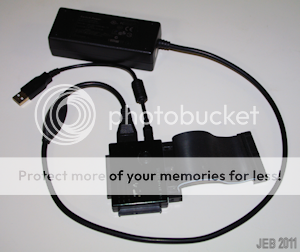

1. SATA/PATA(IDE) HDD connector:
A simple enough setup to throw in the bag and carry when needed. In simple terms this is a digital junction box able access, read and write SATA or PATA (IDE) drives. Attractive features on this model include the inline Power Switch between the AC Adapter block and the 4 pin Molex connector adding power to the device, to bad it isn't light with a dummy light. Having a 4-5 inch IDE 40pin ribbon cable makes it easier to connect to and access the larger drives but is not needed for the smaller laptop drives. Also, not having to carry a socket to AC Adpater power cord is a plus as most offices and homes have extras.
There are a good number of models of this on the market. Find one that'll work best for you but be advised don't make a snap buy on this one or you may find yourself buying it more than once.
Plan to spend USD$20-30 on this item.

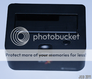

2. SATA HDD Docking Station:
A deskspace occupier able to read both 2.5" & 3.5" form factor SATA HDD's. In simple terms this is a digital junction box able access read and write to any SATA drive plugged into it. I use a Thermaltake BlacX picked up for about USD$20 but I see the price has more than doubled with the newer models able to read up to 3TB drives. If in a med-lrg business environment it's nearly a forced purchase but small and non-business users may be able to avoid the additional cost for a year or two. In that time the prices may drop.
Not shown is the AC power Adapter powering the device and the oval button on the lower right corner is not the power switch, the power switch is on the back panel (also not shown (I use google, you can too)).
