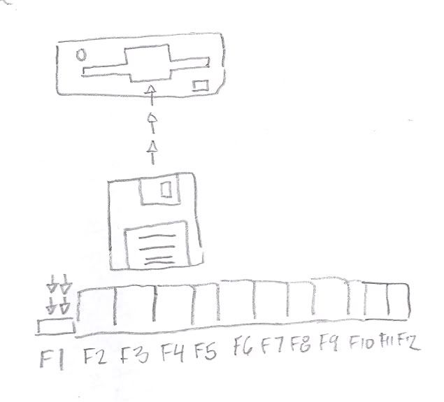

Regardless of which option I selected, I eventually was lead to this screen. When I then inserted a floppy disk and pressed F1, I heard a beep and the screen blinked but nothing else happened.

Doing some research I found that all IBM Aptiva's use F1 to enter the BIOS.
Thats what your illustration (which is now a cool avatar) is trying to tell us DOH!
Try it and see if you can get in the BIOS. See if it is recognizing the hard drive
