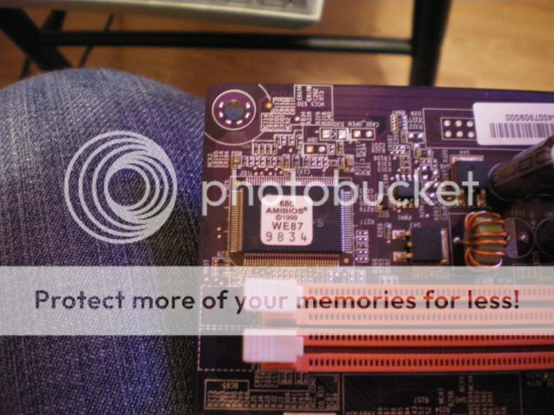

well eariler on i went to update my bios. well it turns out there is 2 bios for the exact same motherboard i have and i turns out i picked the wrong one. well how can i recover it if it is possible with the bios i have. if i hit the power button,the cpu fan spins from 2-4 seconds and then turns itself off. here is what is written on my bios.
686 AMIBIOS
1999copyright
WE87
9834

some high res pics of motherboard and bios chip
motherboard
bios chip

Edit: I see your BIOS chip is soldered to the motherboard, this means if the BIOS recovery fails, you have to ship this whole motherboard out. :thumbsup:
