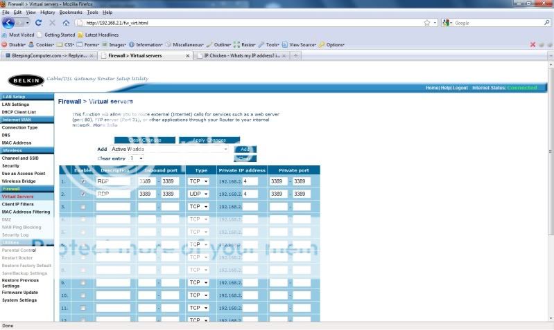

I'm having real problems with making RDP work on my windows 7 machines from outside my netowrk at home. I am using two windows 7 machines with pro and Ultimate installed on them. I also have a home belkin wirelss router.
First let me start by saying i can RDP inside my network from computer to computer using both internal ip addresses and computer names,.
The problem starts when i try and remote RDP eg from work to home. below is how i have everything setup.
- I have my router forwarded under the virtual servers tab to port 3389-3389 and to the ip address of the machine inside my network e.g. 192.168.2.4

If you can connect from other computers on your lan the problem must be in your port forwarding.
Look up your router at portforward.com and it should tell you how to configure it with directions specific to your model.
One thing you might also try, is termporarily setting your dmz in your router to your local address and see if you can connect to it remotely then. With the dmz set, all ports are open and pointed to your computer so it should work. Don't leave this setting like this, just do it for a troubleshoot. If you set your dmz and you still can't connect, then your cablemodem may be a router as well. This could mean that even if your belkin router is configured properly, your modem has that port closed before data reaches your router. If you can connect remotely with the dmz set then it means your router wasn't configured properly for port forwarding before.
More and more isps are using modems that are also firewalls, and if you are unaware of this it can be a real headache trying to make this work.
Again, don't leave your dmz set. Disable the dmz again after running this test, or your ports will all be open and you will not have firewall protection.
I checked that website and followed how to do it for my router and that was how i was doing it in the first place
Ijust tried using DMZ with my local ip address (192.168.2.4) and it still didnt work. Do you think the cable modem might be acting as a firewall as well then? so really i have 3 firewalls to get past?
Is there way around this if this is the case ???
thanks for your reply :huh:

Kalon is on to something regarding the ISP modem/firewall. The easiest way to find out is make a single Ethernet connection from your ISP's device to a workstation. Restart your workstation (or release and renew) and see what kind of IP you get. If it's private, like 192.168.x.x or 10.x.x.x or 172.16.x.x, your ISP's device is a router, too.
And, yes, there is a way around it. Find out first, though.

In case I'm not able to reply, if the ISP's device is also a router, you can:
1. Eliminate your Belkin device and use the ISP's device as the only router. Set up port forwarding in the ISP's firewall. If you have the Belkin for wireless, you can disable the routing and firewall and configure it as a simple wireless access point.
or
2. Call your ISP and ask them how to bridge their router and how to setup your Belkin's WAN interface to work with their service. You would setup port forwarding in the Belkin.

I have found the address for the cable modem 192.168.100.1 when i log into it, it does'nt look like it is a router is just give info about the modem and there are no option at allow you to chnage any thing.
