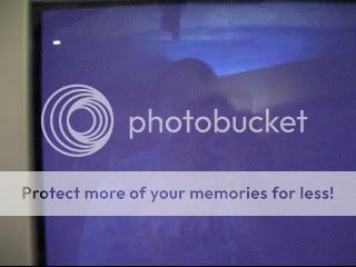

That black screen with the blinking cursor in the upper left corner...usually indicates an MBR or boot option problem.
Are you sure that you are using a bootable DVD?

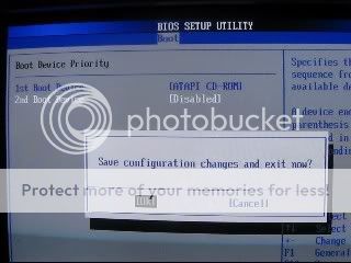

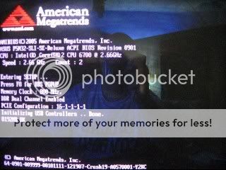

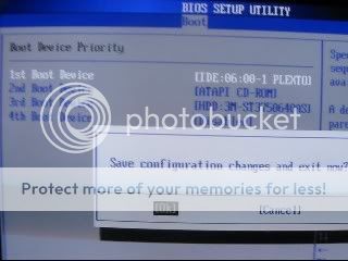

Okay, here are some screens which I hope will better explain the situation. Please forgive the poor quality as well as the small size, I took some screenshots from a video that I took with my camera using movie maker. I will try to describe them as needed:
Here is the normal screen when booting up:
Here is the next screen in the normal booting process:

I select Boot Device Priority and get this (this is the normal startup list):
I change the order to put my Plextor DVD drive in the 1st slot:
And after saving my changes and rebooting, I get the black screen with the blinking cursor:
I tried another option, disabling everything else but the "ATAPI CD-ROM":
And upon reboot, I have another dialog:
It's a little hard to read, but it says "Reboot and select proper boot device or Insert boot media in selected boot device and press a key."
All of the above occurs with the Windows Vista 64 bit Ultimate in my dvd drive. I hope this was helpful.

I have an AMI BIOS on this system, similar to yours.
From what I see...your problem seems to be that this Plextor drive is not detected on the main BIOS screen. That screen doesn't detect any drives at all, other than a Seagate hard drive...in reality, it should reflect every drive which is properly attached to the motherboard. External drives, of course, would not be reflected.
The fact that your other drives show up as boot devices...conflicts with the fact that they don't show up on the main screen.
Which might indicate that you have them set up in RAID mode...on the RAID portion of your BIOS. The Silicon Image screen (2d one) indicates that you have a RAID controller on this motherboard.
That's the only explanation that makes sense to me for what I see on your BIOS screens.
http://www.asus.com/products.aspx?modelmen...2=11&l3=227
Disable the RAID controller or take the system out of RAID mode...according to your motherboard manual or Asus website, and all drives ought to be reflected as they should...in a non-RAID mode and reflected correctly on the main BIOS screen.
That's my best guess :thumbsup:.

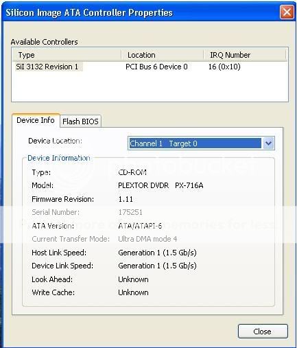

I don't know if this is important or not, but you said the 2nd screen that I posted referred to a RAID setup. After a few seconds, that screen changes and then lists my Plextor DVD drive. In my Control Panel, there is an option for Silicon Image ATA Controllers, and here is what is displayed:
Again, I don't know if it's helpful or not but I thought I'd try. :thumbsup:

Control Panel is not the problem...it's the BIOS which is supposed to reflect that information.
The only thing I haven't suggested which makes some sort of sense...you might want to replace your CMOS battery.
FWIW: The info you posted re the controller...is supposed to appear in Device Manager. With the possible exception of printers...that is where controllers and all devices attached to the motherboard...should appear.
