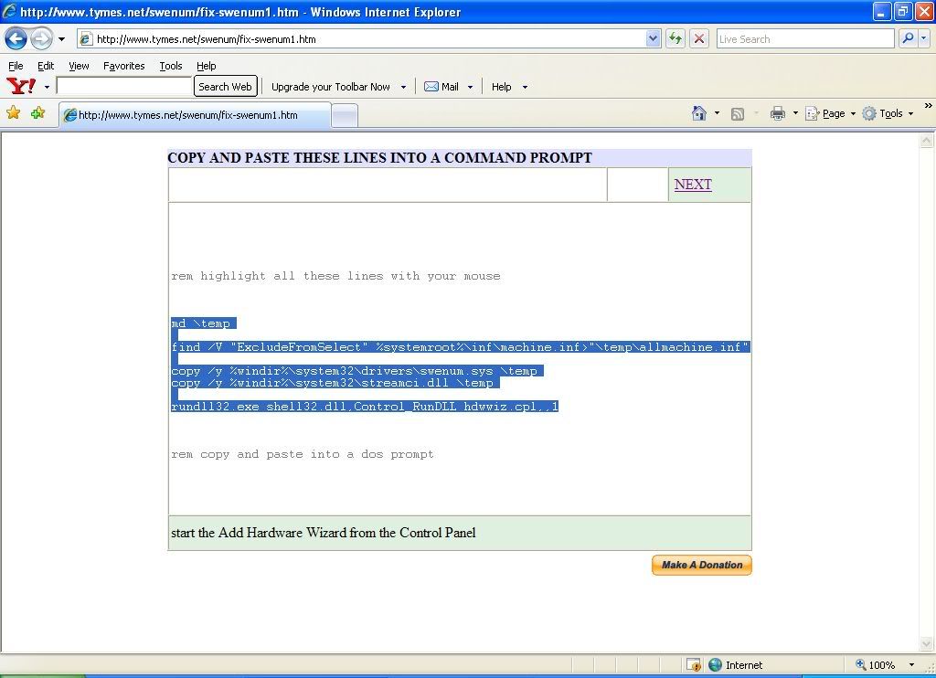

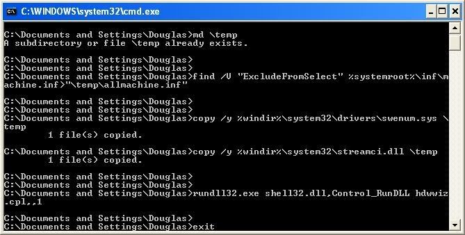

Once you click on No, the next page opens...Move your mouse down to just before md...left-click and hold mouse button while dragging to the last character 1...All text should be blue...Right-Click mouse...select copy....Next you are going to run a command...Press Start> Run> cmd...OK...A DOS Command box opens...Cursor down to the end of the text and Right-Click mouse...Select paste...It will run a program then stop....Type exit and the box will close...Then follow the rest of the fix using the hardware wizard...

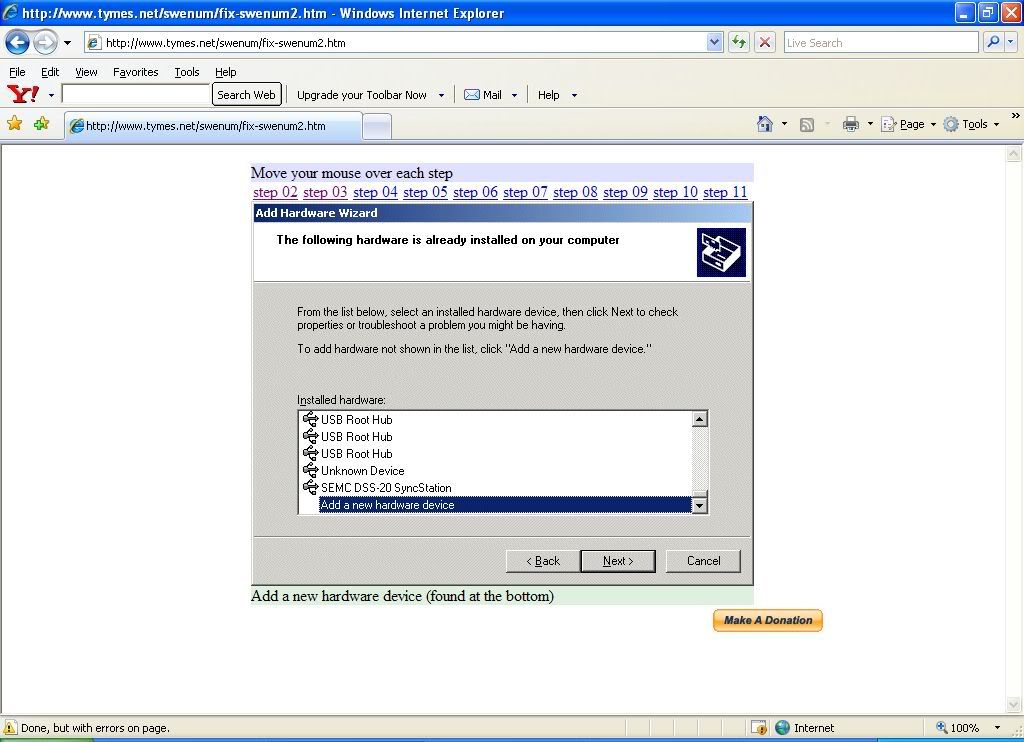

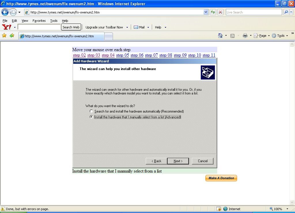

OK, I'm not sure where you got lost, but we'll go through this step by step. I'm going to start from the beginning so if you have already completed some of them just skip down to where you left off and go from there...You can do this!!!
First we are going to establish a temporary file in your C: drive containing the changes to machine.inf and a copy of two files needed to re-install the missing Plug and Play System Device Enumerator.
Copy the following:

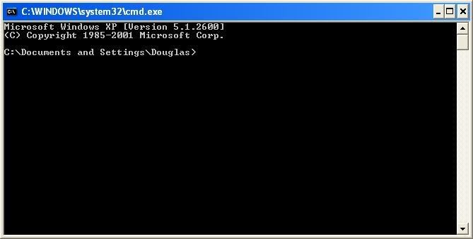

Open Command Prompt>Start>Run>type cmd>OK...Right-Click near end of text and choose paste. Script will run.
Posted ImagePosted ImagePosted Image
Type exit and enter to close the command prompt

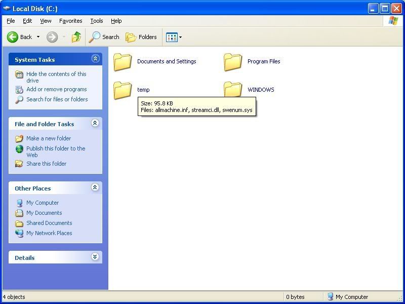

Temporary file should now be created. Should find it on your C: drive. Labled C:\temp. Looks something like this:

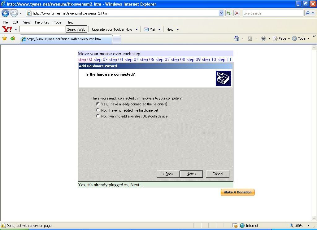

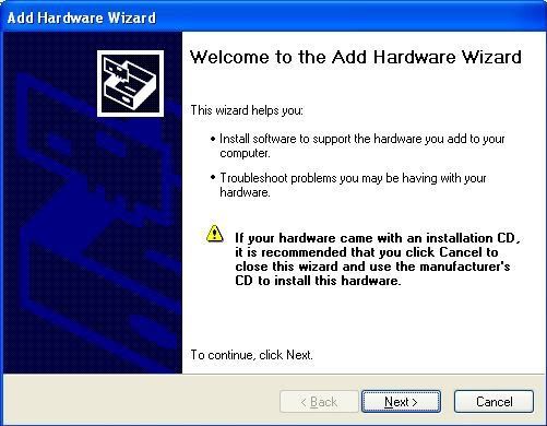

Open the Harware Wizard if it is closed.
Step1
Step2
Step 3 select Add Hardware Device
Step 4 select Install Hardware Manually from list

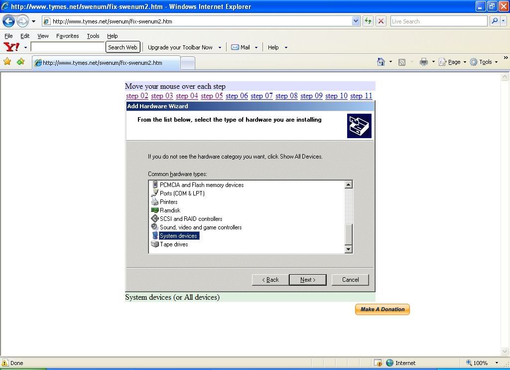

Step 5 select system devices (all devices)

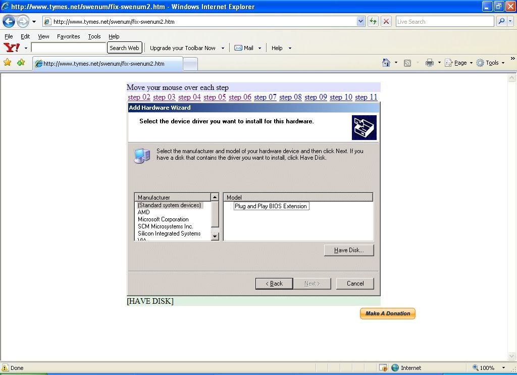

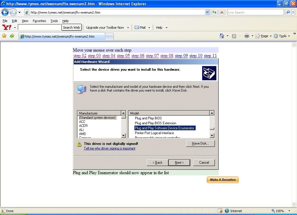

Step 6 highlight standard system devices and press Have Disk
Step 7 Type C:\temp\ in box click Next

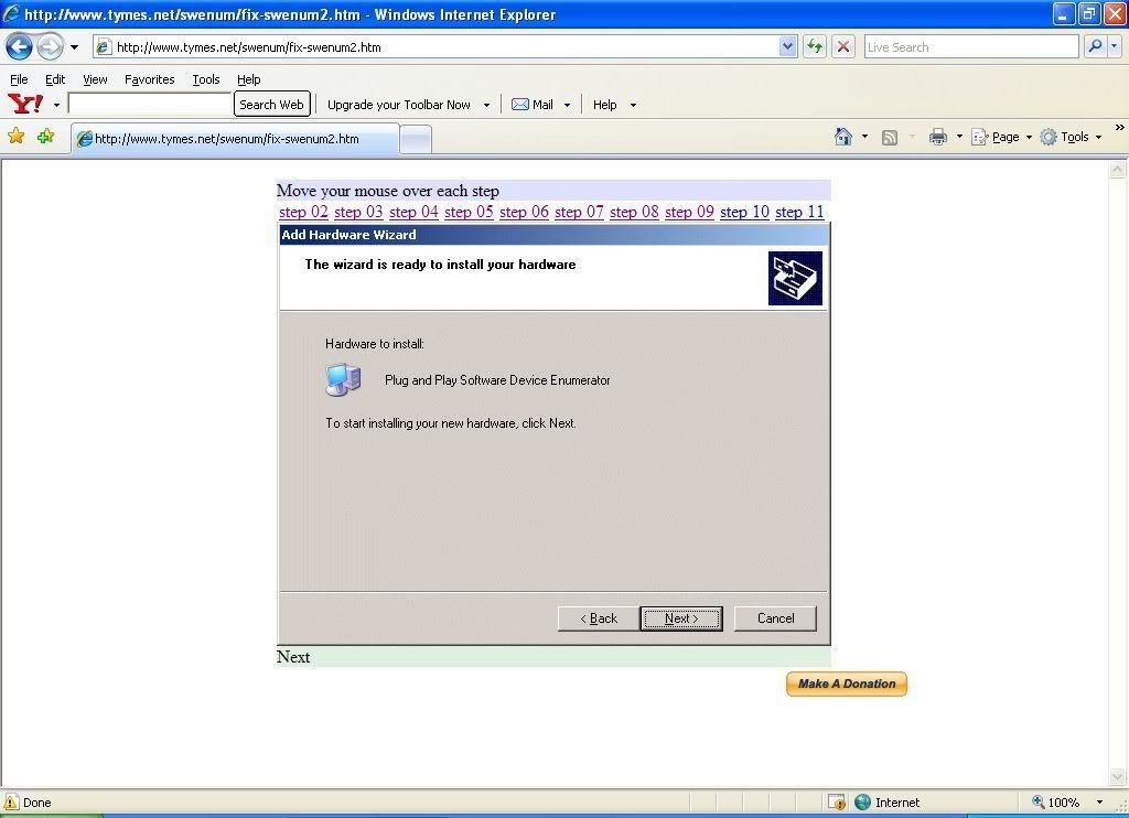

Step 8 Select Plug and Play System Device Enumerator from list on Right

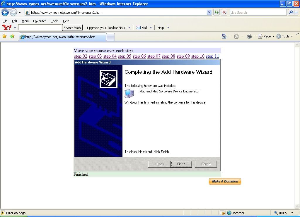

Step 9 Installing Click Next
Step 10 Click Finish when Done
Plug and Play System Device Enumetator should now be in the Device Manager. If there are no conflicts with it or any of your sound drivers you should be good to go...

on step 5 there is standard device to click on mine has nothing above AMD

After a long look at this procedure there seem to be a couple of errors. At the step that you are having problems with don't worry that standard system devices doesn't show up (it will)...At that point DON'T select anything from either list, just press HAVE DISK. Type C:\temp in the box and press Next...standard system devices shows up on this screen but we don't care any more, from the list on the right cursor down to "Plug and Play Software Device Enumerator"...click on it the click NEXT ( not Have Disk)...Then just let it finish.
