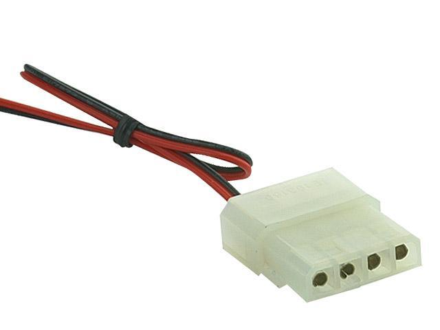

Hmmm, I can't really get a clear view at the plug itself (I did a pretty intense job of cable management and I can't get to the plug), but it seems that only a red and black come out of the fan. I didn't remember that as being the case, I hadn't looked at this in a while. Then, next question. I'll take off the molex head, but I'll need some extra cable length. . .I'm ok just cutting out some cable from random parts I have lying around correct? I would assume it would be the same gauge, and I'll keep it the same color for convenience.
Edit: Here's the connector, courtesy of newegg:
Also, seems like it's a 12v fan, that'll do fine with my 12/5/off switch.

The molex connector has two black wires which are both - negative, the yellow wire is +12VDC, the red wire is +5VDC. You want the +12V and one of the negative black wires. I would just cut the yellow and black wire from the molex connector and leave the other two connected to the connector with tape or heat shrink over the cut wire. You can use solder or crimp connectors to splice you wires, black to black, yellow to red. Use a similar gauge wire if you are going to extend the length.
