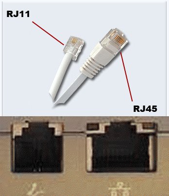

If you were previously on dial-up then I do not believe you were using the ethernet port. You used the smaller port on the modem.
The two ports do look similar with the ethernet port being the larger of the two

according to these specs: http://support.acer.com/acerpanam/desktop/2010/acer/aspire/AspireX3300/AspireX3300sp2.shtml
Networking: LAN: Gigabit Ethernet WLAN3: IEEE 802.11b/g Modem3: 56K
You have both an onboard modem and a lan port. As ThunderZ states the lan port is the 'oversized' port. See the attached imaged for comparison purposes.

Ok the right port above, the larger one is the one that is no longer working. What can I do? Thanks.

Thanks for the specs and pics Animal.
@ ErikEverhard. The specs state as you suspected that all you have are 2 PCIe slots. Yes you will need a PCIe NIC to use one.
The bright side of this is PCIe NIC`s are rated at 1GB transfer rates. You may or may not notice a slight difference in your connection speed. If you are ever hooked up to a LAN = Local Area Network with other 1GB capable machines then you will notice a difference in things like file transfer speed.
